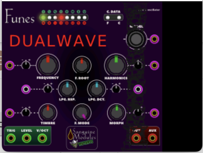

Thanks for the report. Immediately I had a lot of trouble with this library trying to get its faceplate and backplate to show up, they have a transparent faceplate overlaid on the backplate.
Does the MM support syntax like this?
Similarly, panel->addLayer doesn’t seem to work
I had to write a workaround for the above just to get one of the layers to load:

OK, I see what’s happening. There are three PNGs it’s trying to overlay with transparency. What we need to do is make the background one the panel (since that’s always the first/lowest layer), and then make the other two SvgWidget children of the ModuleWidget.
I tested it out, seems to work? (just in the simulator I didn’t bother fixing the font):

Update: pushed to branch faceplate-fix
I also made the same fix around the same time as you lol
I’ve updated the repo with font fixes, and also laid out the labels a bit better so they dont overlap on the MM.
I had to truncate some of the labels just as they are really hard to place anywhere at a reasonable font size.
