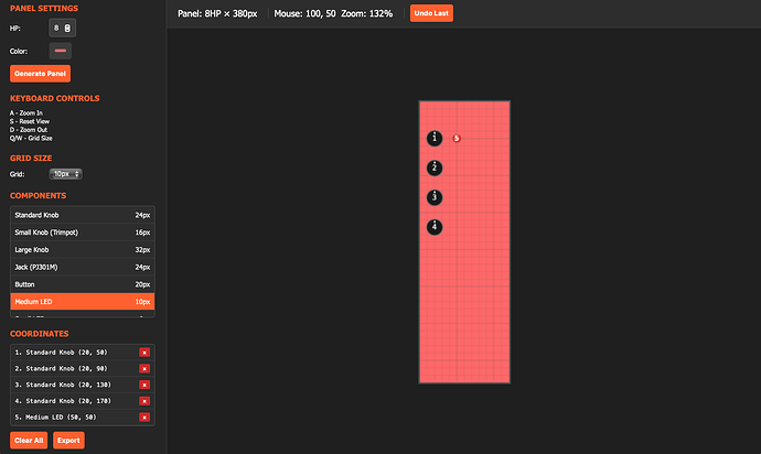

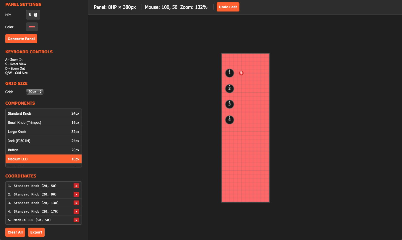

I
built a html to plan the UI layout, which always took me long time to ask AI.
You can download it here: https://www.dropbox.com/scl/fo/9twcltngqfi52akefe223/AHfHF_RElfZeGAfV3exZkBo?rlkey=et7uoq8qgbd9126fs83yaqonx&st=9hmjnlnp&dl=0
@mmmmmmmadman wow this is so useful! Can you share that UI builder?
@janritter - just follow the link he posted…
