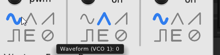

edit2: Getting underway with a ton more modules! However, seeing some with UIs that I don’t if are supported, like this UI element representing the “Range” for VCV Library - Squinky Labs Booty Shifter
Similarly - all these buttons are like radio buttons, not sure if they’re supported. Would be great to map a knob to it. I am able to change this waveform selection to a knob in the metamodule port, but not sure if there’s anything we can to to preserve VCV rack connectivity

Hmm… these kind of UI issues take some creativity, going from a mouse-based UI to an encoder UI.
If you can make it a knob and have it work, then you might need a way to translate however the VCV module saves its state, into how MetaModule wants to see the state. So, probably start with looking at how the module saves this parameter value in the dataToJson() function. When you save a patch with the hub in VCV, it will store the output of this function in the patch file. Then when you load that patch file on the MM, it reads the json from the patch file and feeds it back to dataFromJson(). So if you need to do any kind of translation, putting it in the << plugin’s dataFromJson() might be the place to do it.
So it ends up mapping pretty well with a RoundSnappedKnob or whatever the name is.
It would be nice to somehow give visual feedback though as to what mode you are in, besides the position of the encoder.
For example, the Stairway filter has a bunch of different configurations, like 4P Low Pass, 2P Low Pass, 4P High Pass, and so on - you kind of are left guessing and have to just listen to figure out what mode you are in, it is nice to have to have some text to tell you what mode you are in.
I tried a rudimentary addLabel but I don’t think this is supported in MM yet.
