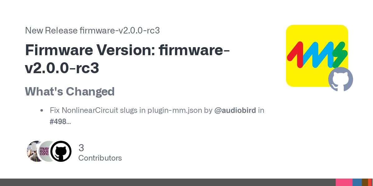

I fixed this in v2.0.0-rc3. If you have a chance to test it out, let me know:
Will test ASAP…thanks!
Did some initial tests…still hear a bit of distortion when using 32K but it clears up when using 48K (could be aliasing artifacts). No more interaction with graphics. Much better…thanks!
