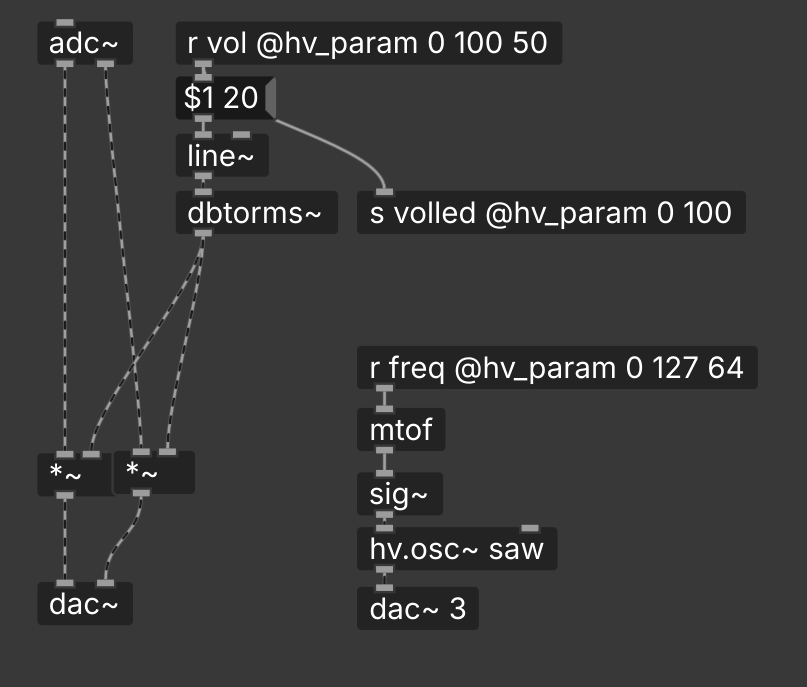

I’m looking for beta testers and feedback for the new Heavy Compiler Generator for MetaModule!
The past few weeks I’ve been working on this new wrapper for MetaModule Native plugins: start with MetaModule generator by dromer · Pull Request #405 · Wasted-Audio/hvcc · GitHub
It will convert exposed parameters to knobs and LEDs and audio-i/o to jack sockets. I’ve added a way to include custom assets, but if you omit this config it will generate a panel automatically as well (you can still set the panel color if you want). A screenshot.png is generated either way for convenience.

An example export command would be:
hvcc metatest.pd -m metatest.json -g meta -o bla -p ../../heavylib

Awesome, I made a simple patch, and it worked! I didn’t play with the custom graphics, but the auto-generated one looked fine. All the element names were ok. It even survived a sample rate change without dropping the pitch.
This is great.
