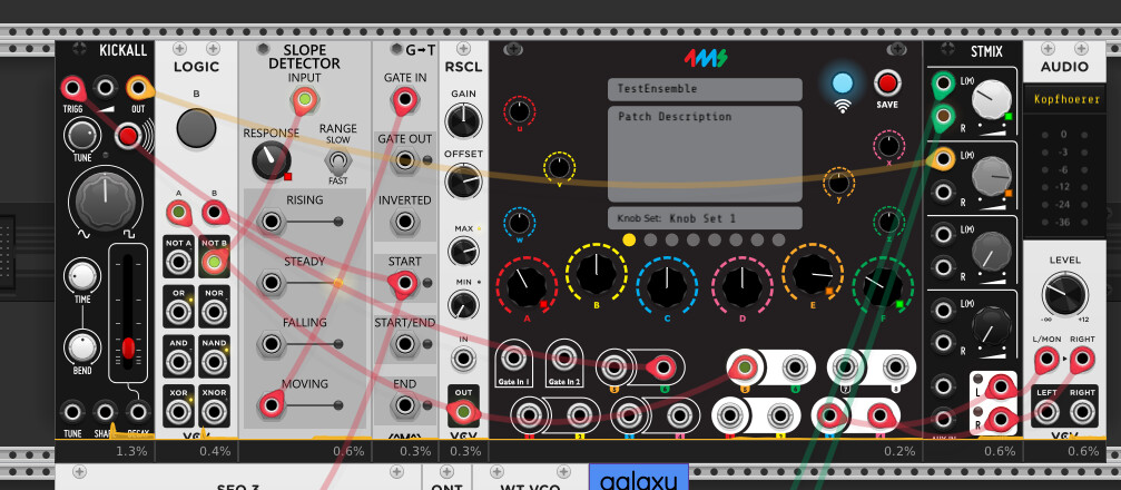

Thanks for your answer. I tried that and connected the scope to see something. But nothing happens. I think this is because the Foot Switch is completely passiv by itself. So I think one has to do some sort of trick with providing an offset voltage and pulling that down or so.

I pretty much did it like that before already but with A-B Switch. A lets the voltage though and B is 0V. It works with a Slope detector, the G->T you suggested and I felt it worked better with the Not B logic in between. (its now a real switch, not just a latch but I need 1 Trigger per Footstep).
